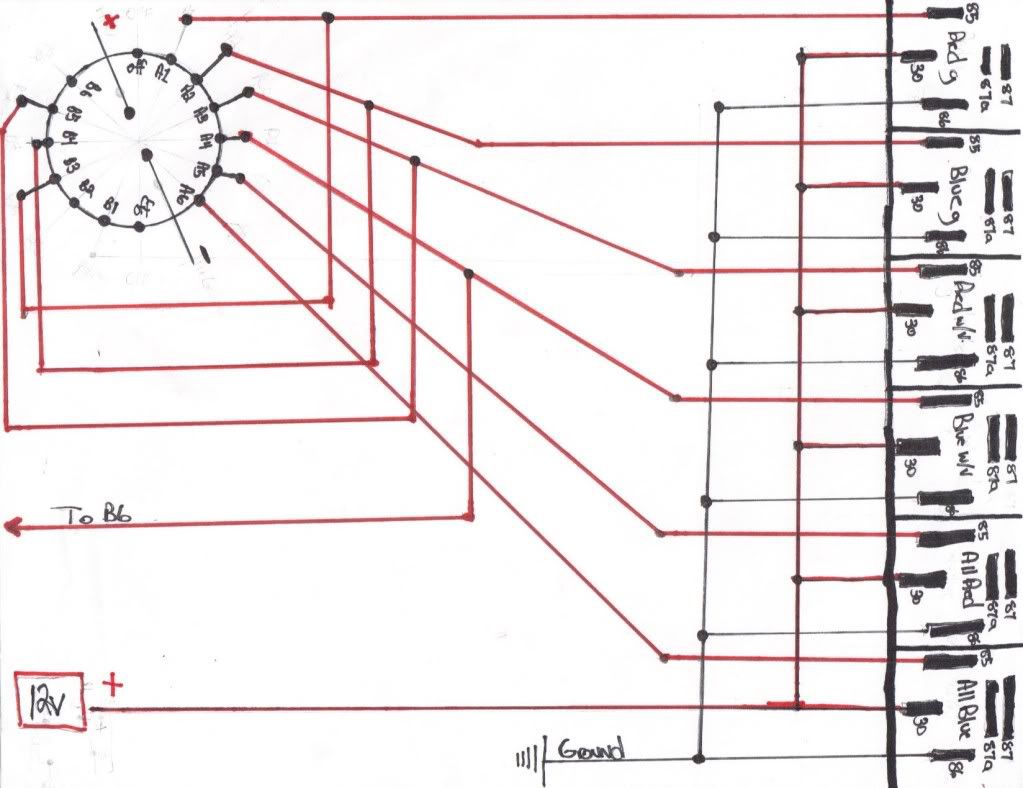

wiring... countless hours. I did most of it, in my downtime at work. (same as my 65 led brake light)
I'll try to get a vid(s) up tonight. I've told lonnie that like... 5 times... i hope i remember, and don't fall asleep
heres the wiring diagram (from lonnie)
it does require some tweaks. The red/blue final stage, needs a branch from the power output from the relay, to the gauges (instead of just floors) and a diode on each line, so the floor lights don't turn on with the first two stages. There was something else too... but i don't remember. (the relays he drew, aren't the ones i used. so some translation is required, but thats pretty basic)
btw... thats JUST the wires going INTO the switchbox. None that are coming out. it was a beast of a project. and that box.. is only like... 6" long by 3" wide.
