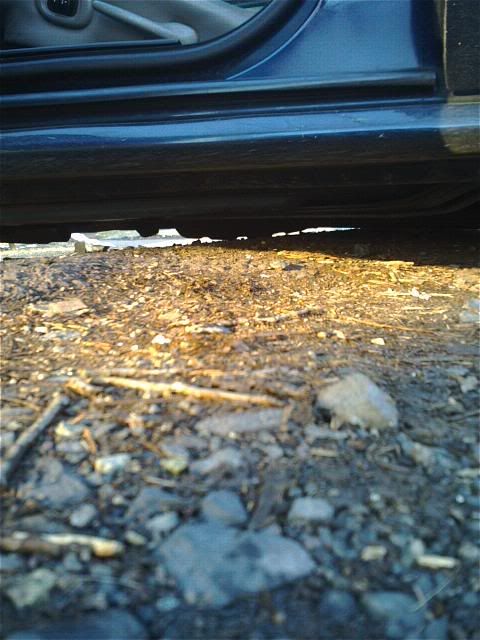

mine hits the tunnel a little but I tucked it way up. I am lowered so I want the clearance.
this is pullin out of my drive with the stock exhaust
