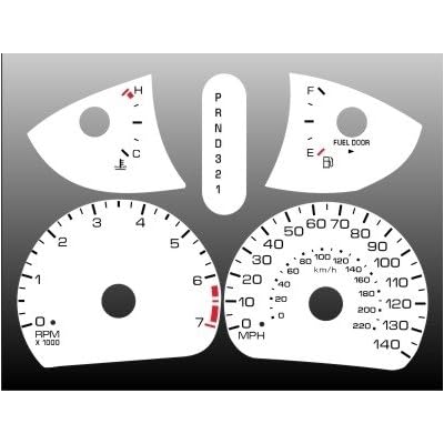

how do i remove the blue stuff off of the gauge face?
am i suppose to peel the face off?

you gotta sand it. funny cuz im workin on my gauges right now as well!

i got red leds and the blue is really restricting its ability to shine through. i scratched of most of the blue, but i was wondering if i got this
could i take the old face off so the red will shine through better, or do i need to keep the stock face on?

those just lay over the old faces, like it was said before take some really fine sand paper, like 1500 grit and sand off the blue film...
