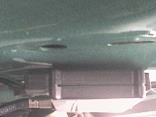

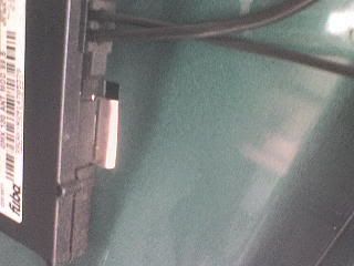

well the weather finally broke (its about 40 or so today and for the rest of the week) and I had time to take a look at a couple of things only to find out i don't have the torx head socket to take off the seat belt, but i managed to take a couple of pics..they're not very good but i think they're of what is the module that controls the antenna/ rear defrost..my question is...is there a way to tell that its burnt out with out hooking up one of the voltage testers? also, is there another one on the driver's side?
Fyi...I've come to really hate my haynes manual...for those who don't have one...don't get it...it covers the mailbu/cutlass and ga/alero..and they're "model" car(s) are the malibu and a grand am...mostly the 'bu
I apologize for these pics being sideways..thats the only angle i could get

Ya that module is something to get to when you cant get the seat belt off. from what i see, i cant tell if it is burnt or not, in the first pics, those 2 cables are built in the module and they come with it. On the second pic, they both disconnect. The circular one is from the radio antenna, the other one is for power of the defroster. For me it was this one that was melted in the module.
