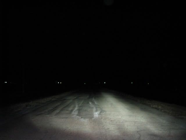

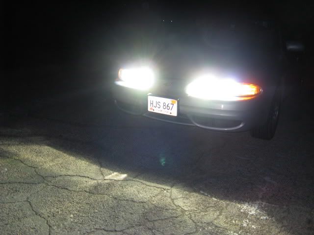

Well, I just installed my 5K HID lights tonight, and I am very happy with the results. I have no idea why I didn't do this earlier, it is definitely one of the first things to be done on all my cars from here out. I got them all in and adjusted slightly higher then stock halogen aiming, and i shit you not with the highs on I can see damn near a half mile down a flat, dark highway. It just amazing. Heres some pics, but they don't do any justice whatsoever.
anyone need a tan? lows and highs on together
lows only. notice how you can see one and just a little of the second pole.
lows and highs, now you can easily see 4 poles and some of the fifth. you can see the fifth no problem at all in real life.

they were a lil too low to use all the new light available. its only 3/4 turn higher so not bad, i've probably met a dozen cars so far and they didn't bother. I just need to make damn sure i shut the highs off earlier than i used to so i don't blind someone now, literally.
