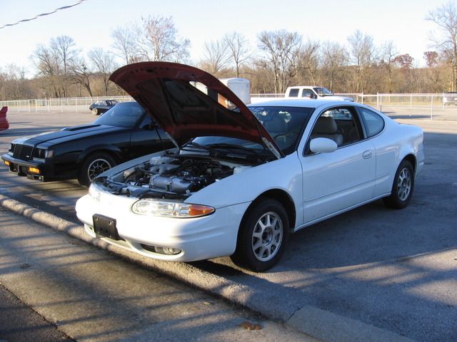

B, how much was it to make the m90 like the m62? Info would be appreciated.
Old 02-06-2016, 01:45 PM   #49
Maybe $400.00-500.00 materials plus fabrication, welding. But you would probably have to notch out the hood brace on the front drivers side.
Old 02-06-2016, 05:57 PM   #50
Did you notch it on yours?
Old 02-06-2016, 08:15 PM   #51
Yeah, but since then I did get a little more room. I don't know if a stock hood would clear it. Hard to see on this pic, but it's a notch on the right side of the "A" section of the brace near the top next to the vent opening on the hood (vent hole not as big as it looks) I can't find the other pic right now
Old 02-07-2016, 05:12 AM   #52
I think i see it. But hard to tell.
Old 02-08-2016, 01:36 AM   #53
Found it. See, it's not too drastic.
Old 02-08-2016, 10:31 AM   #54
Oh so you notch the hood not the core support.
