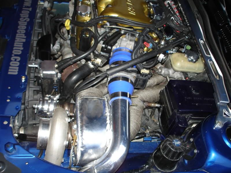

SHES ALIVE! Finally!
(dont mind the gauges, the car isn't started)
Shes alive! finally! Fired her up tuesday night, Had a tweak an issue of the misfiring. Ended up being 2 of the injector harnesses wasn't plugged in all the way. Then she purrred like a kitten.
At 2k rmp, she begins to spool. At 3k rpm, she starting to sound like a tornado sucking everything in. At 4-5k.. shes just LOUD! Like a jet. Is the car quick, It is quicker; Not that quick as i have all the fiberglassing, stereo, 20" chrome wheels. And only 6psi.

Beautiful. Done with the same attention to detail and craftmanship that we have all come to expect from you. and FYI I heart your gold UIM.

kewwwwl you drive around with no air filter? or you goin by the chipper/shredder rule?

Just gonna put a screen on there. No room for a filter. Just need to get my ass to home depot and get a 4" clamp. Which i'll do that tomorrow.

why not get a musroom filter like greddy or hks filters, short and stubby?
and uh whats the deal with the coolant rail what was the reason you hacked it?

That is a huge turbo! Good quality job man.

No room for a filter.. I got 2" btw the frame of the engine bay and the turbo inlet.
The coolant rail to the heater core is modifed to fit the downpipe tube. cut the line and routed a soft line to the front.

i had a question about the oil catch...umm have you picked up any oil?
correct me if im wrong but doesnt THAT pcv suck up little to no oil? again correct me if im wrong, cause i mean ive changed that line before but i didnt find any oil residue in it, but i could be wrong, well i mean i have seen dark build up in the lim but i always thoguht it was from the egr

I have picked up some oil. I had the catch can before the turbo. It caught like 2oz of oil. I dont have my EGR anymore either.
