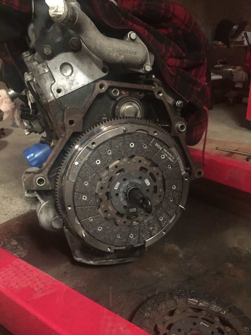

Well yeah, but when taking apart a clutch/flywheel, and use a new clutch on a say, 30k mile flywheel, its ideal to get new. Or resurface the flywheel, but GM doesn't recommend doing that. They flywheels are basically one time use unfortunately,
And i doubt ill find a g6 low mileage, my flywheel had 38k on it before second gear synchronizer gave out. Its just not ideal to reuse a flywheel with a new clutch, you have to atleast clean the flywheel surface up before throwing it all together, if you dont and the surface isnt level, smooth and clean. You can end up having terrible clutch slippage, despite having a new clutch in there.

We have a machine shop here that will machine dual mass fly wheels... we have used them after he machined them and never had any problems!

Yeah the energy ones are always nice too! No one here could service that flywheel for me sadly.
Old 03-21-2015, 09:52 AM   #95
Nate if you and Scott can work out a deal it might be beneficial to ship him your old one to be machined here and ship it back.... then you have an extra... all depends on the cost of course....
Old 03-21-2015, 11:13 AM   #96
Yeah, ill see what i can do. Or i may just buy the last new one available and hoard it lol.

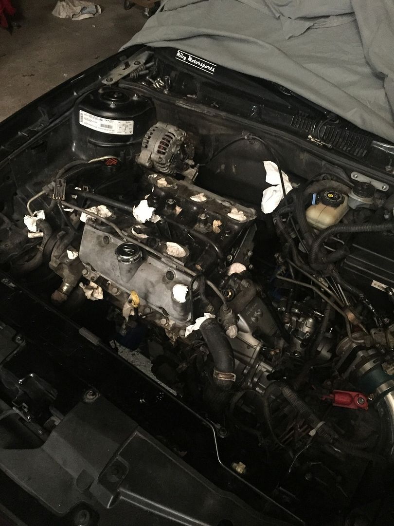

Progress this morning!!!

Its in! Makes me happy!
