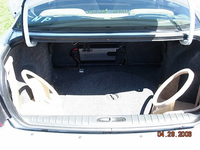

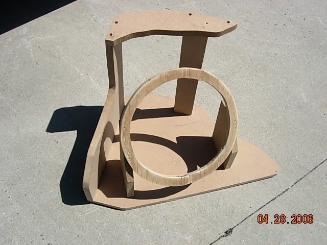

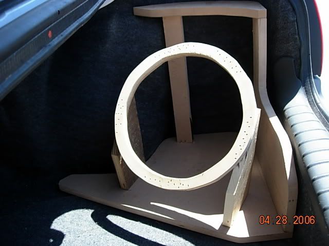

well, here's some pics of the skeletons i build for my rear sub boxes. they weren't too hard to build, and i intend on stretching glass across the forms. should end up nicely. for a finish, i'm going to use the granite type spray paint to match the factory carpet.

thanks. the plans for the amp are to mount it in the spare tire well with a liquid blue neon under plexiglass. i'm pretty excited. the amp is down the road tho, doesn't have to happen quite yet.

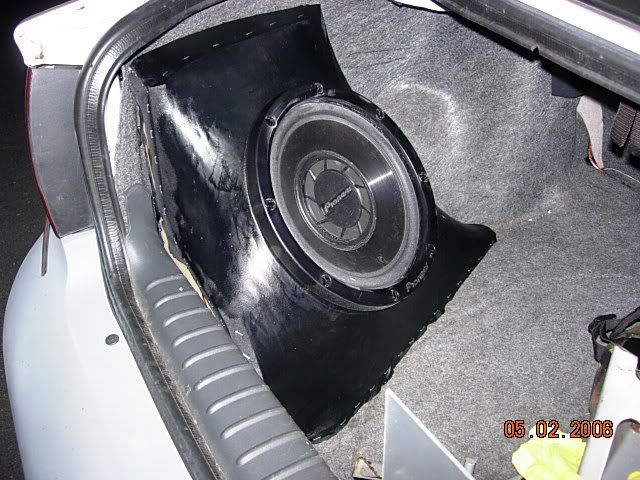

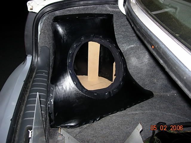

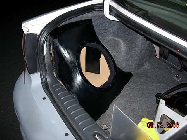

new pics of progress.

Can you describe whats covering it
looks like the usual black fleece

actually it's a spandex type material. i'm going to glass over top of that, and then bondo and paint.
