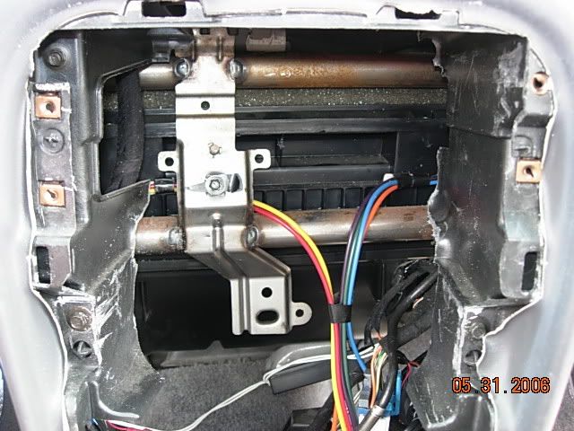

Posts: 1,537
use a hole saw, and then break it out. no one will see it anyways.
Old 06-01-2006, 04:52 PM   #11
2fst4u
[boosted 2.4L]
2fst4u's Avatar
Posts: 1,537
had to make a little extra room. lol
