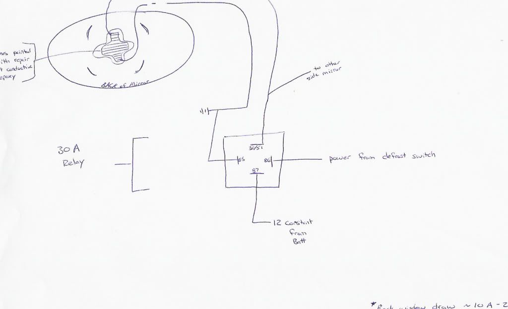

Now, after some research, I believe this should be relatively possible.
As per the diagram... only a small section of the center, or either side would need to be if the center already is missing a small section, that'd be perfect, but i doubt it is.... so i'd have to somehow remove some plastic, and some adhesive.
A)dremel the plastic out, then heat to remove? any ideas out there?
B) would removing the black plastic backing cause any visiblity issues with the mirror?
http://i178.photobucket.com/albums/w...mirrormock.jpg
^Basic wiring diagram.
The back window draws ~10A (if anyone knows the specific number, please... post it) but i figure the sides shouldn't pull more then 5A each, and the timer set on the rear will kick off the power to the sides, if used as the power activating the relay....
so.. ideas. I'll be getting some side mirrors soon, so if we can get a general game plan of how this should/can be done, i'll GLADLY post up a well illustrated HOW-TO for the winter weather Aleros.
and does anyone know just how well the conductive epoxy repair kits work? its either using that, or buying resistor wire from ebay and making my own mesh with that stuff... which is would prefer to use the paint on rather then the latter.

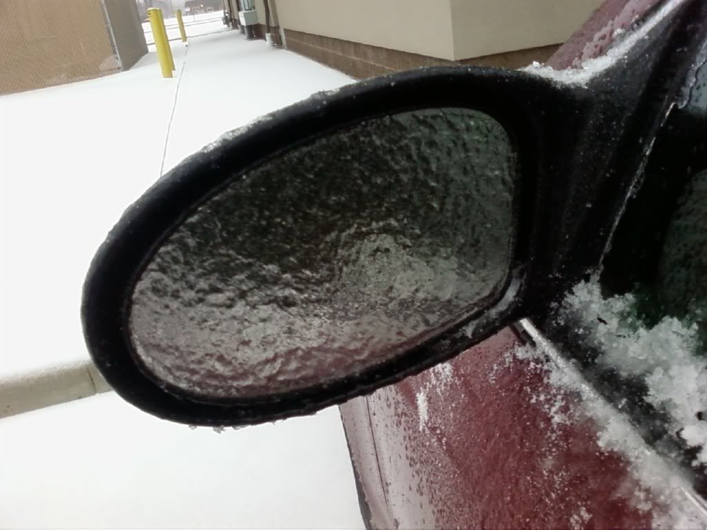

and to anyone who says "just you a scraper" you don't have to deal with this on a regular basis, do you?
http://i178.photobucket.com/albums/w...n17/frozen.jpg
