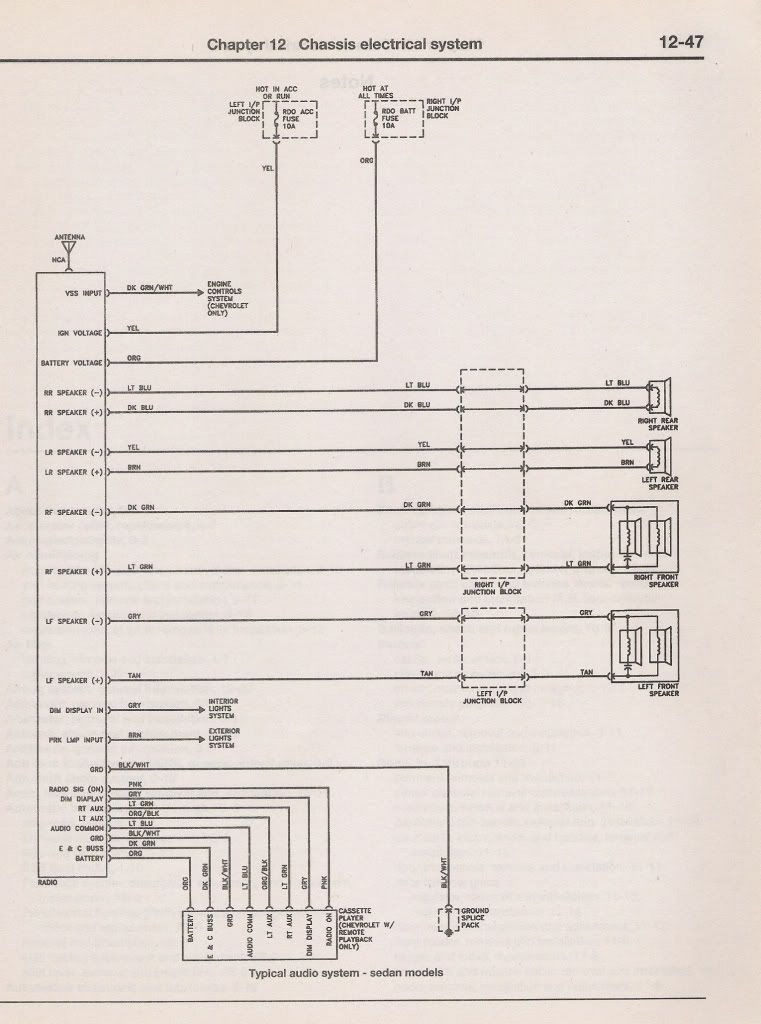

so i have a problem, im installing my new deck as we speak and i have two problems. the black cord with the metal piece at the end doesnt fit and two i just got the stock wire harness by accident of not thinking, i neeed to now just go directly to my deck, so does anyone have a wiring diagram to do so. and some help would be lovely, thanks

wiring diagrams are on site.
@ the bottom.
http://www.aleromod.com/forums/showt...iring+diagrams
and doesn't fit, as in, not enough room or wrong size?

that doesnt work, its not a very descriptive diagram ah
and the black wire is too small as in width

you need an adapter. they should have one at the place you got the wire harnesses from.
