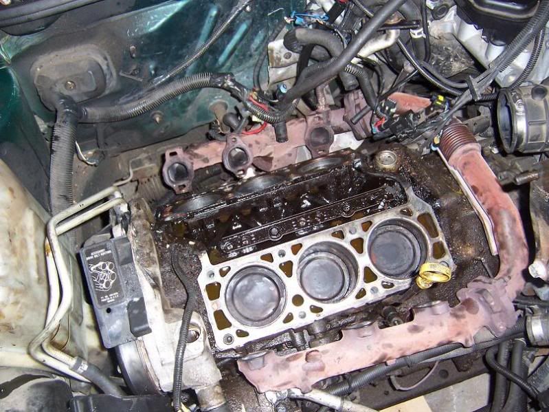

Did some tests today.. cyl 5 and 6 had super low compression.. did the teaspoon-of-oil-to-seal-the-rings trick on them and compression didn't increase any... looks like the heads are out too..
Well, wish me luck guys, gonna be my first ever complete teardown and rebuild.. hopefully no cracked blocks like on the last one I went to change.
Old 06-25-2009, 03:06 AM   #12

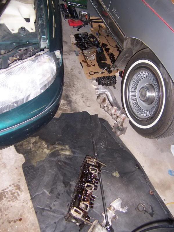

Well... so far so good basically. Teardown didn't have any big surprises or anything.
I'm on the very last bolt for the rear exhaust manifold then the rear head will come out... but it's being such a SOB. I think it'll be easier in the morning when I'm rested though. How exciting. Here's hoping it all goes back together.. at least mostly.. tomorrow!

Pictures or it didnt happen.....
its not like its super difficult to tear down a 3.1 or a 3.4
ive done it enough
Old 06-25-2009, 05:33 PM   #15
Habeeb it.

Blktrax is on a distinguished road
Thats some great head right there.
