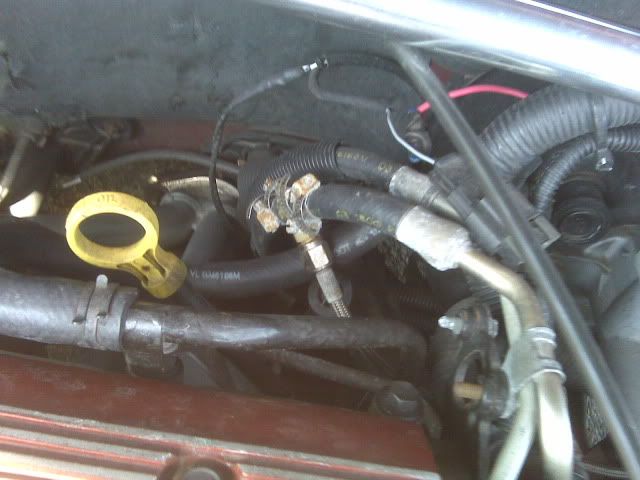

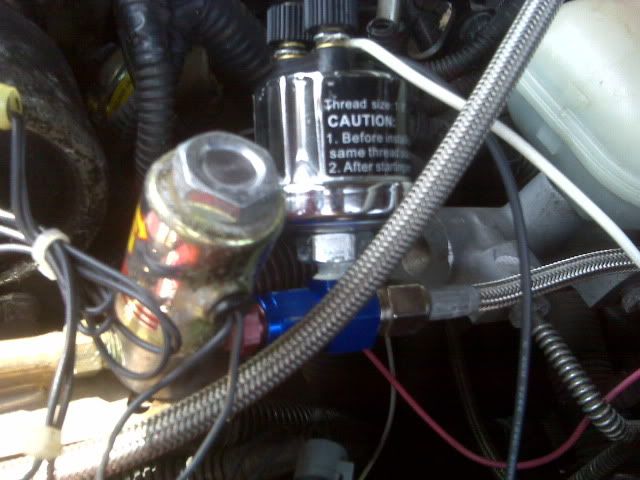

Don't know if this will help but heres pics of where it was installed (The feed line)

Old 04-08-2010, 06:09 PM   #18
Is that just stuff that goes to your pressure gauge??
I'm assuming you've been basing your readings off of just the gauge?
Get a mechanical pressure gauge, and disconnect that silver fitting from the blue thingy, and send it into a pressure gauge... see what you've got then... your gauge may read wrong.
Can you disconnect at all where the rubber line meet the metal?? That'd be the absolutely easiest it looks like, but I dunno if they're disconnect points or not.
