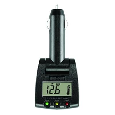

If I were made dictator, I'd require that all new cars have a voltmeter installed. For now just go to WalMart and pick up one of these:
Equus 3721 Battery and Charging System Monitor
