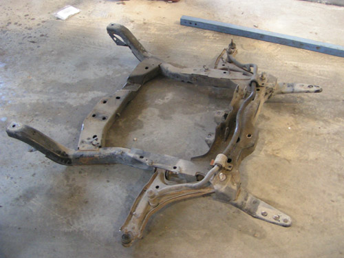

Here are the Pics of the install had to remove the crossmeber, take the sideplate off the tranny, remove the pump and valve body.

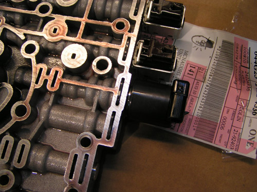

Pressure control solenoid, its the big one.

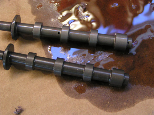

updated shift valve bottom old one top. The new one does not have the bleeder holes.
Crossmember

The UP is from GM, Its a kit, With the Valve Body spacer and Shift Valve, also we put in a new Pressure controle Solinoid.

Sorry dood no link But for the Valve its just 2 Bleeder holes they removed, and the valvebody plate has been updated. You can get it from you GM dealer. its NOT an easy install Its a total of 9H from GM

the valve looks a little beefier in the pics too, in addition to the bleeder holes removed...
they where pretty much the same - the bleeder holes remeber the old one has been sitting in my tranny for 125,000Km
