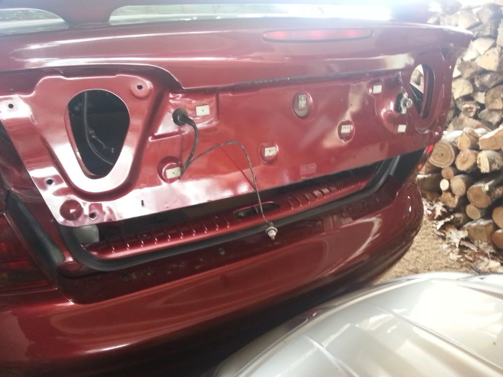

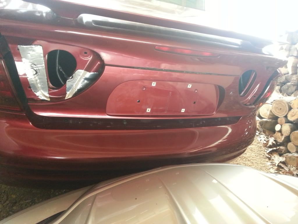

I was busy this morning stopping the rattles as much as possible. First, took off the plastic component of the trunk.
Then put some knukonceptz kolussus sound deadener on the worst places.
Put the plastic part back on
Drilled out one of the factory mounting brackets and held it together with a bolt and washer.
View of the washer.
