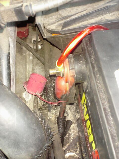

So kinda noob but when I connect my power cable to my positive side of battery its so hard to screw in. any answers will def help me, is there any way to switch to a diff kind of battery say a battery with connections on top instead of those stupid screw ons? Thanks!

Well there are optima batteries with dual posts. But you can get an adapter if you do not want to spend the money on an optima battery. Now how bigger of system are u installing.

This is what you want.
http://www.ebay.com/itm/Stinger-SPT8...fb7f&vx p=mtr
It's the "GM battery adapter".
They sell them at Advance Auto and they go for $4.

Thanks it fit perfect and have no problems!!! Now to buy a new amp because it won't turn on lol. It was an older amp so i didn't think it would work. I also did my ground to my shock nut in my trunk.

I got a couple of those bolts from best buy when I still had a regular battery. I have an optima yellowtop with dual posts now. I love it, no more power drains!

I picked up a new side screw bolt with an attachment to run something off the battery. I think it was $5 at Advance Auto. Works fine

JLw7123: Yeah I did all of it myself. I have that remote wire and the power cable on the same side. I already connected it to the back of the head unit with the blue and white striped cable. I installed the side adapter with no problems. I have a pic ill upload but its a lil messy. Ill buy a new battery soon and clean everything. I'll be upgrading to a 4 gauge soon.
