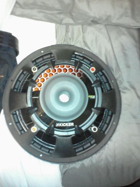

It all depends on what sub you have is it dual voice coil, or single? Is it 2ohm, or 4ohm? A pic of the back of the sub would help us help you.

Its dual and 4 ohm. Pic is here

Iirc, for 4ohm you jumper the negative on one voice coil to the positive on the other. Then take the two terminals left, and hooked them up to the amp. It should have all this in the manual that came with the sub.
