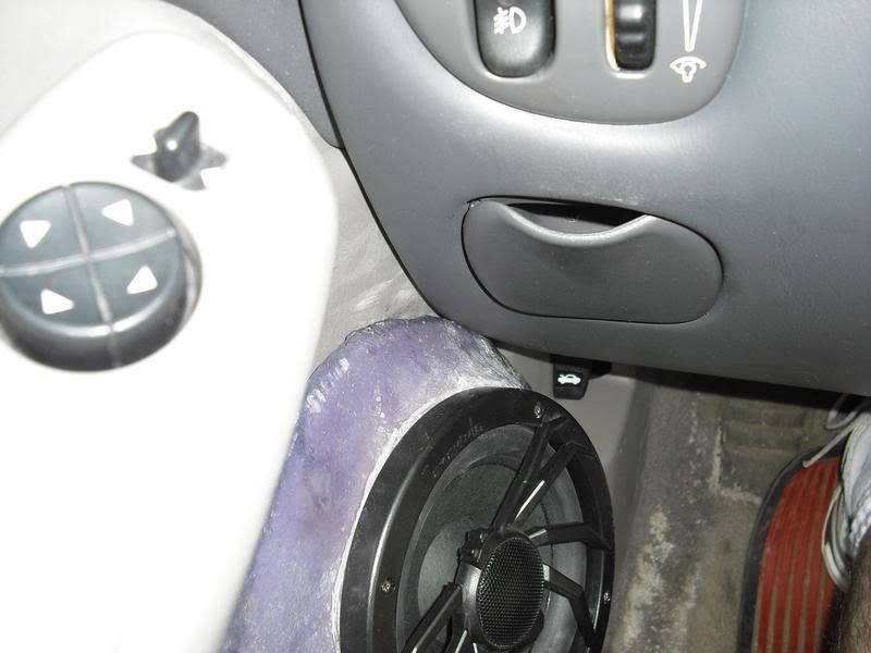

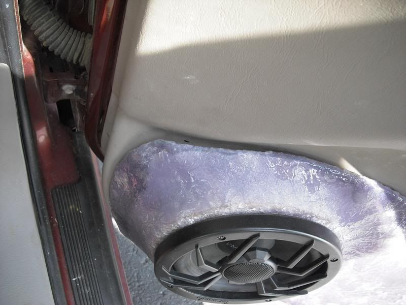

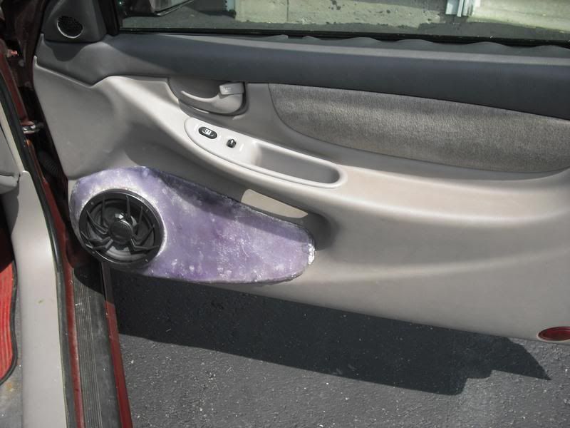

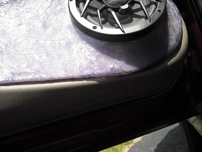

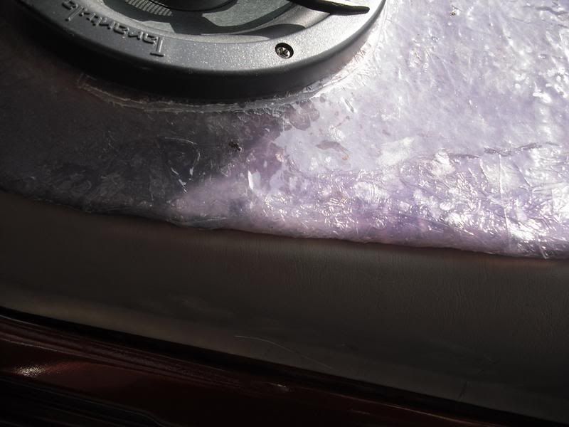

well... i had to see how they fit. I gotta say, for my very first attempt, its not to shabby. (not the best appearance or quality.. but i'm a noob at everything this project entailed)
Driver's side... Like a glove!
Bottom seam isn't bad.
Front end isn't horrible. Just needs some sanding.
Passanger side.. isn't as nice. It was the one i worked on the most, at first. Its... rough.
Ha.. oops (you can't see this old hole straight on.. or unless you look closely. Its covered, I just need to do alot of sanding to get the edge below this more even, so this sits flat.
Bottom seam is decent.
Just barely sneaking by the glove box...
I gotta thank quad4, for these doors. I'm tearing them up pretty good, but they are spares, so I can. I gotta bondo these still, vinyl wrap them (still deciding on black or pewter) then mount to my actual doors, until I can revinyl these current ones.
So... advice/critique?
Ryan, the new amp sounds amazing with these. I love this setup. I'm sure the imaging isn't great, but it sounds good to me. Much better then before.
EDIT: The purple is just the color of the resin.. I had no control over that. And I'm aware the passanger speaker is mounted upside down. I was rushing things.
