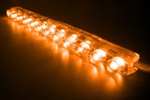

im also thinking of putting one of these in each rear turn signal in place of the bulbs
or im going to buy the led's and make a mount for them. im thinking 25 in each side

Well your LED strips have resistors built in them... I'm not sure what other LEDs you have..
