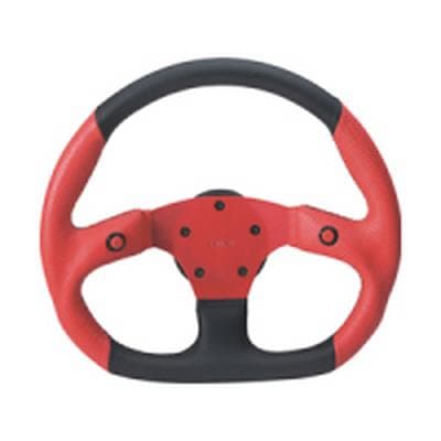

i HATE the big steering wheel
i was thinking of changing it
is it possible and does anybody know what the specifics are tht i would need to know when buying one
Ideal wheel below

My Ideal Wheel

That wheel you posted resembles this massive bucket of eff I just seen.

you need to get a steering wheel puller, or even a 3 jaw puller will work. have to remove all of the trim pieces and then you disconnect the air bag and pull the wheel off with the puller.
you then get the correct hub adapter, i think i used a 96-02 full sized chevy truck hub adapter or something along the lines of that. then its really just following the instructions from the new steering wheel manual. make sure you get the matching brands hub adapter as you cannot mix these because of the mounting holes for the new wheel.
****you will have an air bag light on your gauges after doing this***

Changing to a smaller steering wheel will not make much of a difference in steering as you might think. It looks good but driving without airbags might also be against your state law / insurance company. What needs to be changed is the steering ratio and since there is no rack kit that i know of... you would have to do a custom job.
If all you want is a change in appearance, and don't care about insurance / laws, do the change with care and definitely disconnect your battery first.
