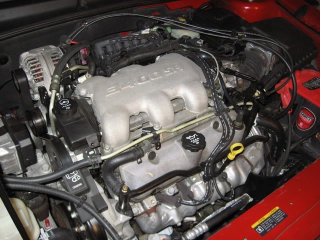

I am having issues with putting my belt back on. What's the best way to do this? Fast answers would be greatly because I am sitting here waiting.

Line the belt up on all pulleys except the 3 inch idler next to the alternator pulley. Take up the slack in the belt and hold the belt with your right hand on the outside of that top idler. Hold the tensioner to the right with the proper tool, and slip the belt under that topmost idler (for V6).

Then you have to have a way to deflect the tensioner to the right, I think a 3/8 square drive for sockets will fit. I'll have to check it on my car, because my own tool is 1200 miles away at this time, too. Meanwhile, see what you can improvise, but whatever you use should be the correct size, because aluminum strips easily

Should be able to use 3/8 drive wrench, slip a pipe over the handle:
Old 02-04-2011, 06:12 PM   #8
Move pipe to the left:

If it's the V6, you really need a serpentine belt tool to get in there. I recommend the Lisle ratcheting serpentine belt tool.

I would say there is a wire that didn't get hooked up to the new alternator to supply enough voltage to keep it going. As for the belt I have been able to pull it by hand and slip it on at the water pump but you need to pull pretty hard. I have changed mine twice like that without a tool.

A 3/8 drive breaker bar works well. I have a short one, it only comes up to even with the alternator pulley.
I did buy a tool that everybody is taking about, took all of 3 seconds to put the belt back on after the water pump swap. Litterly 3 seconds
