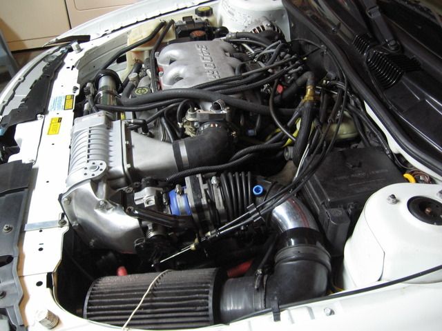

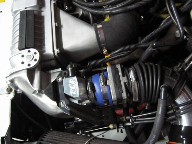

I'm at square 1 with a new blower and trans rebuild, motor is on the way out, though Going to mod one step at a time to see the effect of each. Not as much power as the previous build yet, but it's getting to be fun to drive again.
Stock MAF, bored out TB ( to 65mm), stock UIM, (no EGR), stock FPR, 3 inch exhaust, supposed to be a built tranny, with MMGT1 tune. 2nd burnout in the vid, see slight shadow on the dash from tire cloud
Here's a look and listen, pay no attention to old guy driving, he's crazy.

68mm TB
got to 12 psi, brought groceries home safely
