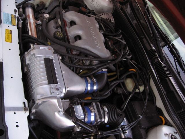

We may have a chance to test these theories. This is turning into one nasty ride (+blue plate clutches and new TC)

I wonder if your experiencing any "loss" of air flowing in the intake with that snaky setup you got there?
i doubt it, an intake can have as many curves as it needs and its still gonna bring in the same amount of air, as long as its not leaking anywhere.
Old 10-08-2012, 11:04 PM   #26
Its easier to suck through a shorter straw then a long one. Easier to suck on 2 straws at once compared to 1

yeah you should get your intake as straight as possible... lol I 've put the battery in the trunk in all of my s/c'ed car, the LD9, The ECO and the L67...and... well my buttdyno tell me it does a difference

I'm at square 1 with a new blower and trans rebuild, motor is on the way out, though Going to mod one step at a time to see the effect of each. Not as much power as the previous build yet, but it's getting to be fun to drive again.
Stock MAF, bored out TB ( to 65mm), stock UIM, (no EGR), stock FPR, 3 inch exhaust, supposed to be a built tranny, with MMGT1 tune. 2nd burnout in the vid, see slight shadow on the dash from tire cloud

What is your cable bracket bolted too ?

Just the one bolt on the TB right now, the bracket wraps around it. I don't know how it will be positioned later, so don't want to tap holes yet. Something changes on it every other day lol
