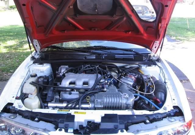

Experimenting with new MAF placement, directly connected to throttle body:

Old 10-23-2011, 04:31 AM   #11
Before we swing into sub-operation "Underkill", a final pic:
