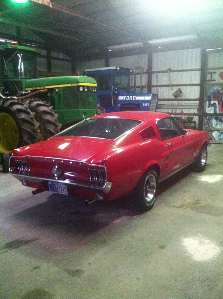

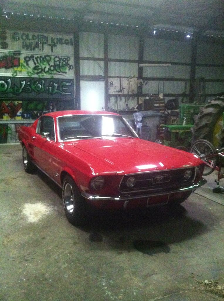

anyway check out my daily driver for the next few days
67 stang
