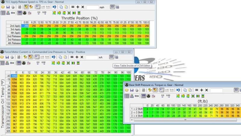

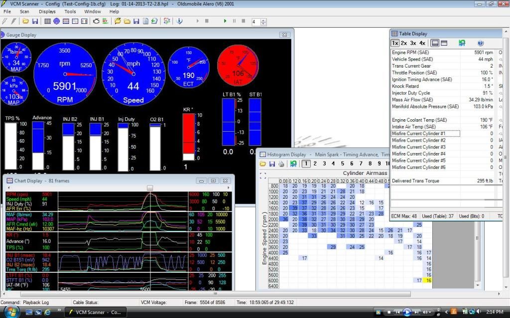

What is your scaner reporting as far as "delivered trans torque" right at the commanded shift point between 1 and 2 bud?

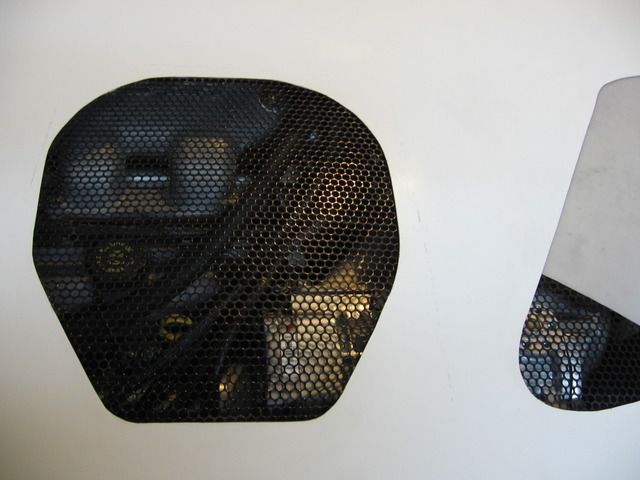

Damn, that blower is loud. No sneaking up on anyone in the white car.
There's a good reason for that. Air filter is under the plastic shield
It drops to 295 between shifts. But when there is a lot of wheelspin, the mph drops and the PCM downshifts it back from 2nd to 1st. At least I think that's what is happening. Doesn't do it with slicks at the track. Might as well post this here too (note: this is NOT a scan of the video, but of a faster rolling start):
I think you are spot on. As far as the shift goes, in your pressure table.... from 250Tq to the top of your table add 5% to it and try it again. The trans is built now, take advantage of it and give the shift some snap. Set desired time to .1 if you havent already
2nd, get bigger injectors bud. What size are you running right now?
3rd, what * Thermostat you running?
I think fuel and cooling are ok, but I don't understand the way those tranny tables are set up, don't see how it could be tweeked further -- max base pressure can't be set higher than 96. Shift times are at 0.1
Old 02-26-2013, 01:41 PM   #48
240-260 is still shifting at 70-80% there. Add 5 to the 240 and 260 rows. With wheel spin I bet you hit that area. Are you experiencing slip? If so, you can subrtact 5 from the force motor table from 132* to 240*, in rows 60-90%. Subtract another 5 in those locations if it still fells like its not grabing. You install a shift kit when you built it? If not, pretty sure one can be installed with a pan drop.
Over 80% in our fueling systems is static. The injector cannot open and close fast enough to feed it properly man. One step up is all you need, nothing crazy. Too big is a p.i.t.a to get any kind of idle out of.
Thanks, might as well tell me the maximum safe limit I can go on the Force Motor table, lol ...... No shift kit, but I used to use a switch that ungrounded one of the solenoids and defaulted it into full line presure, just for the track. I don't know how that affected the tables, but every shift was *WHAM*. I know it means 1-2 tenths in the 1/4 mile.

I would not take more than 15-20 out of any area in the force table. Really, the only time we should really mess with that table is if you are dealing with slip. If you take 10 out, imo, and don't get the grab you want, I'd install a shift kit
