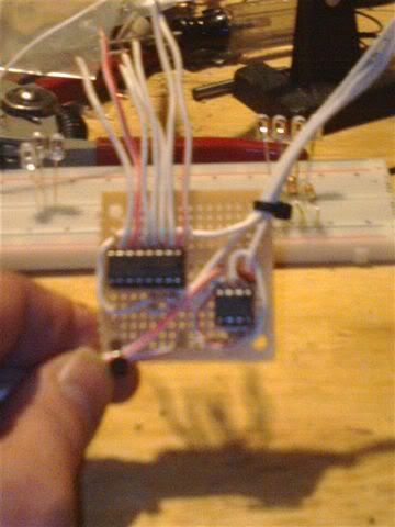

I had my 65 led third brake light wired in to the turns and did the chaser it was a pain in the ass to wire. i made the circut board to do it. then I got a short and tore it out (it was in for 3 weeks) here is the schamatic I went off of.
here is a pic of the one I built
and the led wires befor install (find a short ?)
just giving you a heads up. cool mod just a pain
NOTE: if you don't understand this drawing then research before you start building. I built the board on a 2" x 2" board so its small.

do you mind posting up the pin layouts for those chips? also, how many leds do you have hooked up to each output? this is all helpful information that i wouldn't mind seeing. do you have circuit maker or multisim? wouldn't mind putting together something in there to test it out. might be kind of cool to run the simulation before hand.

555 timer
4017 decade counter
