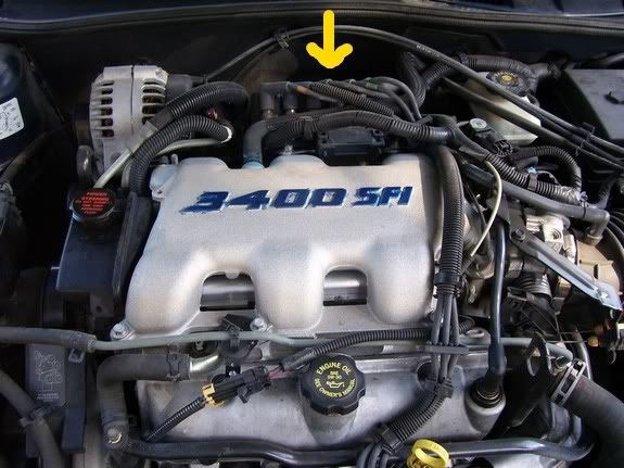

Are you talking about this part???

ok i epically fail at saying what i did... the metal thing that says 3400 SFI, except, mine says 2.4 Twin Cam... lol...

This is the LD9 forum, quit bullshitting about things as if they're even remotely similar to the 3400.
Removing and installing the IDI cover should affect NOTHING. As long as you plugged in the wire harness on the right side, and the spark plug boots are all fitted in and secure, you should have no issues. The four bolts that hold the cover in place do just that, nothing more, no sealing, etc.
There's little springs inside the rubber boots, make sure they're going on right and you have the IDI cover on all the way. The only thing I can think of is that you're misfiring due to poor connection between the coilpack and spark plugs, but that shouldn't cause the traction control light to come on. Wish I could use HPTuners to scan you, could find out tons of info. :/

it was being a pain in the ass going back on... a metal bar above the wire harness had to be kinda forced to the side to get it in/out, is that normal? and it was kinda hard getting it to sit right..

Uhh don't be pushing that metal bar, that'd be your fuel supply line. You have to angle the IDI cover to get it in, then make sure the boots are all aligned over the plugs. You can usually feel when it's all lined up. Ya it is kind of a pain to get it lined up, it's all due to the rubber/plastic boots with springs inside them that have to be seated right.
